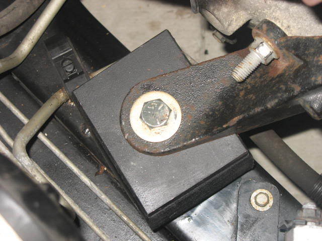

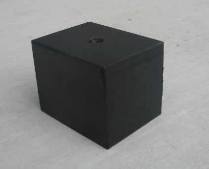

I just replaced my leaky front trans mount last night on my 01 SSEi. (might also work for all3800 set ups?) I def wasnt gonna shell out the cash for a stocker oil filled, so the solid mount was it. I read all the pros and cons (well really only one con, the lil vibration you get) and wanted to find a middle ground. I work for a company that builds hydraulic power units. And some electric motors we use can create vibrations that customers dont wanna here or feel when they walk by the machine, so we use these vibration bars....
this is a 4"(L) by 3 1/2"(W) piece I cut off a bigger piece. I need to grind the bracket a little bit so I can square up the mount with the car, I'll do that when I change out the bolt for one an inch longer, needs to be 7" or longer(the nut is on there...it is.... with lock wash and loctite...plus it started to rain...ugh)

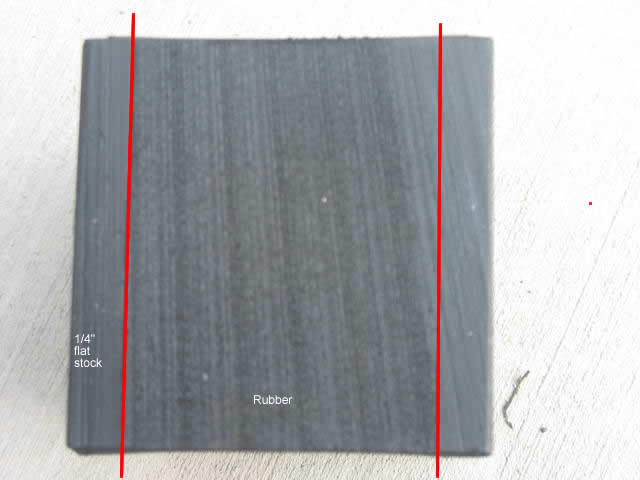

The block is made up of 2 pieces of 1/4" x 3 1/2" flat stock glued,or however you permantly bond rubber to metal, to a 3 1/2" sqre piece of industrial rubber. We get em in varying lengths but I cut off a 4 inch chunk.(seemed stout enough). I rattle canned it flat black for rusts sake, so its hard to see the diff parts.

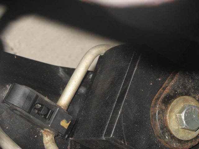

One part that might be a problem is a tube behind the mount that touches it but a lil spin or a 3 1/2" chuck would solve that problem...
