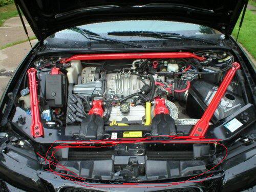

Looking to replace this as I hit a deer and can't figure out what it is...
Attachment 153
waynep7122 08-16-2011 10:47 PM
there are several possible different front ends.. i counted 3... this part all fit all of them.. its item 5 on the bumper parts pictures at gm...
the part between the bumper and the core support
10433271 SUPPORT,FRT BPR FASCIA
